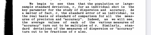

I wanted to make a separate post arguing for an alternative standard for assessing rifle accuracy (precision yes, but since it’s relative to an actual point of aim, it’s still accuracy).
Here’s what Frank Grubbs, PhD wrote in 1964:
So that’s what it all boils down to. I want to come up with a number that represents probability of landing within some distance of the point of aim.
In his writing, Grubbs helpfully provides useful stats tables that can let you arrive at the sigma value (population std error) from samples.
For a 5-shot group, your sample standard deviation should be multiplied by 1.19 to be an unbiased estimate of the population std dev. (Nominal: 50% confidence). To have 95% confidence, that sample std deviation for 5 shots should be multiplied by 1.38.
For 10 shot groups, the factors are 1.084 and 1.3, respectively.
Since 100y is close to 95meters, we could easily then adopt a rule of “the three 95s: the size of the circle representing 95/100 shots landing within it, with 95% confidence at 95meters”
And to arrive at this value, just shoot a 10 shot group at 100y, determine the standard deviation of that group’s radial error from either the group center (precision) or point of aim (accuracy) and add 30%.
If your rifle is perfectly zero’d, then the average point of impact will be the point of aim. So to calculate the standard deviation of your 10 shot group, just measure the individual radial error terms, square them, add them up, the take the square root. If you want to have a 95% confidence estimate for the long run capability, add 30% to that value.
Reverse engineering the stats a bit, you can see just how likely it is for the typical “sub moa all day” claim to be true. That claim translated into stats would be “population standard deviation at 95% confidence of < 0.5 moa” (we use 0.5 moa because we are doing math on radial error against a claim of diametrical error). What does this look like on target? We subtract 30% to get to a sample std dev for 10 shots of 0.35 MOA radial error.
Since basic probability says plus or minus two sigma is 95% confidence, the “sub-moa all day” claim essentially boils down to a 10 shot group with not a single shot outside 0.7 MOA from point of aim. Doable for many on here, but much more stringent than it would first seem to many who make such boasts.
I think I want to make a “Sub-MOA-all day” challenge target scaled to particular sizes that represent real actual capbility. I.E one size for 5 shot groups at 100y, maybe another for 10 shot groups, 20 shots, etc.
Please check my work against this reference and correct as needed: http://ballistipedia.com/images/3/3...lemen_and_Missile_Engineers_-_Grubbs_1964.pdf
I have a copy of the "Grubbs" reference you cite. I have had it for many years and read it many times. It is deceptively simple. I start to read it and understand what I am reading but soon become bogged down and start over. It has some great example problems worked out and if you have a technical background it is not too difficult to follow. Understanding the basic statistical math is a challenge but not necessary for using the information. My vocation at one time involved simulated altitude testing and data analysis of rocket engines and rocket motors so I understand the principals well enough to use them but probably not well enough to teach them. I too see the claims of people having a one MOA gun and you would think that everyone has a one MOA gun.
