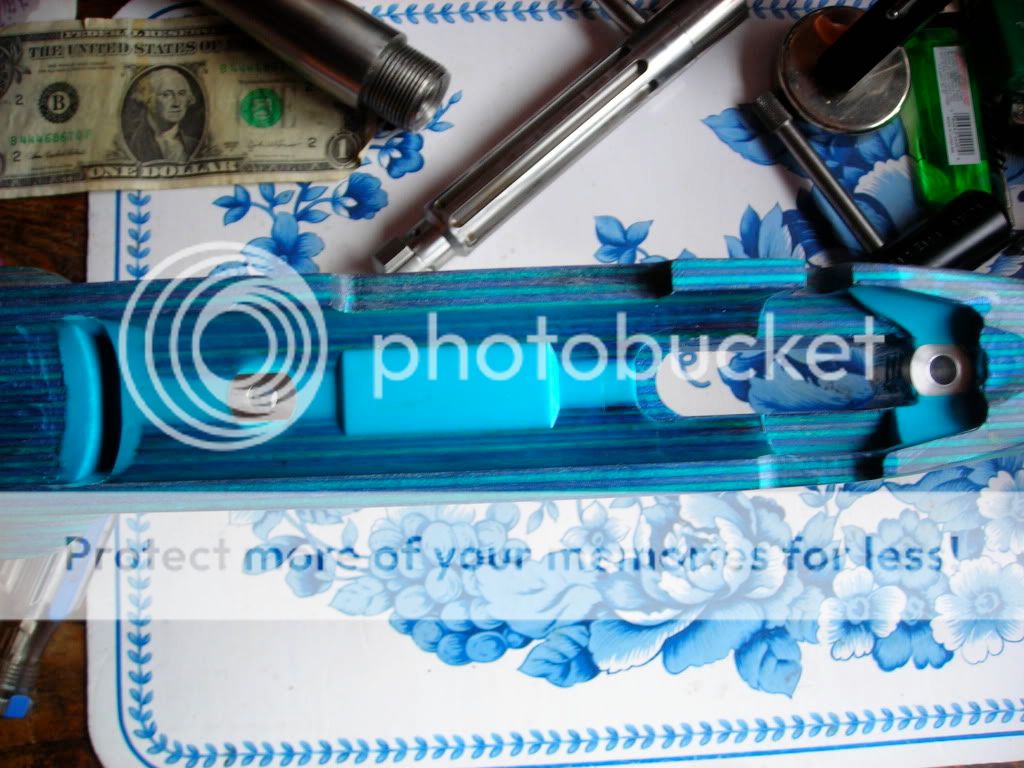

Here's a MBR for a 3 lug BAT he inletted for me..As you can see it is as perfect as it will ever get.. Was no real need to bed it as you can see from the way the glass lays... even the outside needs very little work to have it ready to finish.
Those russo stocks are pretty nice!! The problem i have with the shehane MBR is that they dont have any texture on the grip area. I really like having a little something to hold on to. Also his front ends are a bit different than the tooley MBR. Nice stocks, dont get me wrong, just not exactly want i am wanting. I guess i will have to call Mcmillan and order one. I saw one on here a while back that was GAP camo and i thought that was pretty sweet! I ike the tactical rifles just as much as Benchrest so it would make a nice compromise! I can live with what ever though so if you know of one please pass it along. I cant believe bruno doesnt carry a few more of these than they do. Maybe they just sell out to quick??
