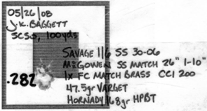

Hello Everyone... I know guys are always curious about new barrels/ barrel makers, and I recently tried a McGowen SS Select Match 30-06 barrel for a Savage action. The barrel is standard Savage Varmint contour, 26" 1-10" twist.
I installed it a few weeks ago and finally got it out to the range on Memorial Day,what better thing to do than shoot on Memorial Day right). It took about 6 shots to get a good zero, and then I settled in to shoot my first group, and I could not be happier with the results...
I shot this group from the prone w/ bipod and squeeze bag support, in the grass/ gravel behind the 100 yd walkway on our range at work.
The rifle is a Savage 116SS action, the McGowen barrel, B&C Duramaxx stock,bedded), Nikon BM 4.5-14x42 SFMD, and Harris bipod. The load information is written on the target obviously. I'll try and get pics of the rifle up as well.

That.s a really great group . did you turn the brass and fire for it to the chamber?
