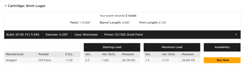

Nobody has suggested in this thread to go above and beyond maximum published loads to achieve higher velocity. If you are referring to the "reddit guy" mentioned above who hit 2170 FPS in his AR9 with the 56gr ARX projectile, he used published data and worked up to the maximum powder charge and recorded his velocity (7.3 grains CFE Pistol) using a slightly shorter/lighter projectile (the 56gr Inceptor ARX vs the 65gr Inceptor ARX). In theory, he probably could have increased the powder charge a little and still remained close to 33,000 PSI if the seating depths remained the same since the 56gr is 8% lighter than the 65gr. If you know anything about the Inceptor ARX 56 and 65 grain, they are identical in profile other than the 56gr is .09" shorter in bullet length.
Hornady 8th Edition reloading manual.
I think there may be a difference between muzzle velocity range and the question of what velocity will the jacket and core potentially separate. The 750-1300 number in the manual may be more of a reference to typical velocities in published 380 loads, but I will reply to Hornady with this info and see if their answer changes.
