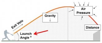

LOL . . . I just don't know why the mystery for so many, as it seems to me to be a very simple concept. Maybe because I've delt with this kind of thing most of my life in two other sports I've been heavily involved with: Baseball and Golf? See here:
'the difference in height at which the bullet would be, from the center of the target, at the target, if gravity did not exist'.
I believe drop can be visualized as the vertical distance between the bullet and the imaginary extended bore axis (when the bullet exited the bore) at a particular downrange distance.
