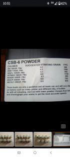

I have been using this data for reloading 9 mm 124 gr bullets. I am up to 3.5 gr and it will still not cycle my FN 509. Curious if anyone else had used it and had similar results. I found 1 other load data for 9mm 115 gr bullets and it had a starting load of 4.3 gr. I guess I will work my way up until it cycles right

Just in case anyone else ever tries this powder. It took 4.2 grains of csb-6 to regularly cycle my FN 509. My other guns would cycle with much lower amounts of powder. The cases did not seem to have any over pressure signs or more recoil than a factory load. I plan on loading out a bunch of them with this powder. I got a 5 pound jug for $100 on close out.
