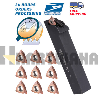

One more thing I forgot to mention, Mauser threads are 55 degrees instead of 60 degrees, You can get a tool holder and inserts on Ebay that work very well from a company called Hartwana. Or you can just use the 60 degree inserts that you already have, That's what most people do. I use the 55 degree tool.
Many aftermarket pre machined barrels came machined at 60 degrees, So it does work sufficient enough.
