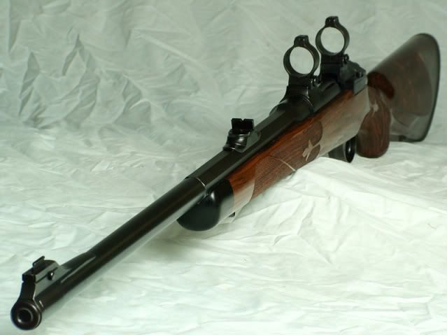

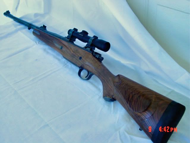

This is my 1909 Argentine in 284. It is a 5/8-3/4" shooter with handloads.
This is my 7X57 half octagon barreled Mexican mauser.
This is a CZ 458 Lott.
This is my Banner mauser in 9.3X62.

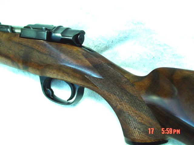

Lookin' good , Butch. Id' bet Butch and I have, at least, a couple of things in common,,,Like maybe a couple of years of tech training at an accredited school and quit a few years of bench experience. I posted the pic of that maple stocked Mauser as just an example. Not everyone who wanders in and posts is just some 'nob'. I don't post much on any forum, probably because I'm busy building rifles,,,,,,, or shooting them. ALL the work on this rifle was done in my shop(by me, I'm the only one there), metal work and wood work. Maple stock blank (not pre-inletted) came from the mountains of Pennsylvania. Inletted, shaped and finished by hand. Shilen CM barrel chambered in 7mm/08, slow rust blue on all the metal, my bolt forging & tear drop on knob, right down to the jewelling on the bolt. The only job I ever send out for is checkering.
