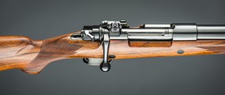

This is my old 458Lott that is headed to Africa for a Cape Buffalo hunt. It is a VZ24.
