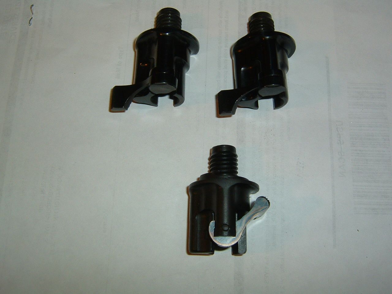

Easy but a little costly . Brownells has kits but Necg has complete bolt shrouds as do a few others . It's a std 98 Mauser , you can reinstall a 98 shroud with a modified safety flag . Other possible is to install the orig Mark X trigger assembly which locks the bolt via a slot milled in the receiver tang . Send a pic of your assembly , I may have a steel factory Mark X trigger around .
I believe any 98 Mauser 3 position M70 type type safety should be no problem to fit to your rifle. I've done lots of them on all sorts of 98 variants and never had an issue. A worthwhile addition.
