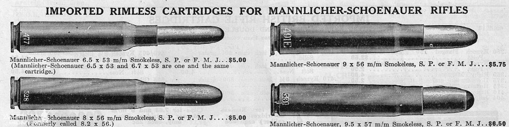

All M1903 actions (not most) that left the Steyr factory, as with the M1900 and Y1903 through 1930 'Greek' MS, were chambered for the Mannlicher Schoenauer proprietary cartridge of 6,5x54.

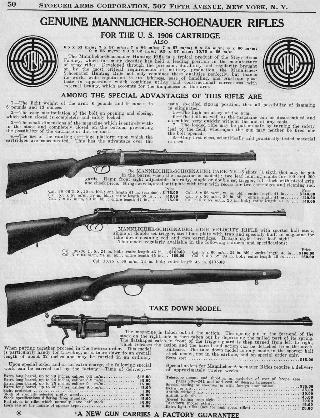

The early models of MS sporting rifles were cartridge specific, each model had a corresponding MS proprietary cartridge, thus:
M1903 - 6.5x54
M1905 - 9x56
M1908 - 8x56
M1910 - 9.5x57 known to british trade as .375 Nitro Express Rimless
The 'stretched' MS action that Laurie referred to started with the M1924 'Sequoia' which was chambered in .30 - '06 in an effort to increase sales to the United States. It also was then that a 'guide ring' was added to the Schoenauer magazine, allowing for greater flexibility with cartridge choices. The Sequoia didn't sell well, but Steyr continued with the longer action in a variety of calibers, mostly metric, and including both 7x64 and 7x57. These have come to be known to collectors as 'M1925', though Stoeger called them 'High Velocity'. They are marked with their 'kaliber' on the front ring whereas previous MS had their model number.
Notice that the Mannlicher Schoenauer was available in full stocked carbine, half stocked rifle, and in takedown form with single or double trigger (single only in takedown).
What has become known to many as a 'Mannlicher stock' over time is actually a stutzen, or full stocked carbine. They were once popular on several European arms and were never exclusive to Steyr or to Mannlicher designs.

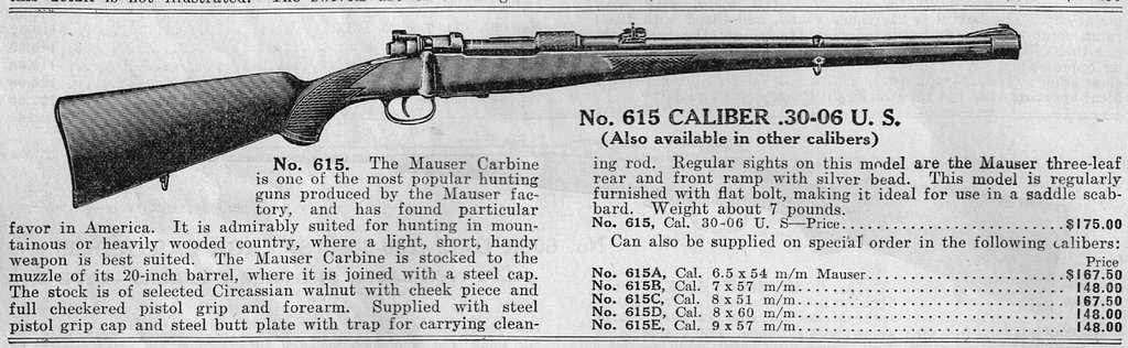

Here is a Mauser stutzen from the same (1939) Stoeger catalog.
Stutzens used to be quite popular in the UK, but not for some time. As with US shooters, such rifles are often misnamed as being 'Mannlicher stocked' over here too. When BSA was still in business, it made an excellent CF2 Stutzen model, probably more with the continental European hunter in mind rather than its home market, but some or even many must have sold here too. I used to see them regularly on the budget end of the second hand market here until maybe 20 or so years ago. The ones I handled were all 270 Win, but I know they made them for other cartridges. The only one I ever saw shot (on a rifle range, not 'on the hill') was remarkably accurate at 100 yards with handloads, so the alleged deleterious Mannlicher stock effect certainly didn't apply to that example.
