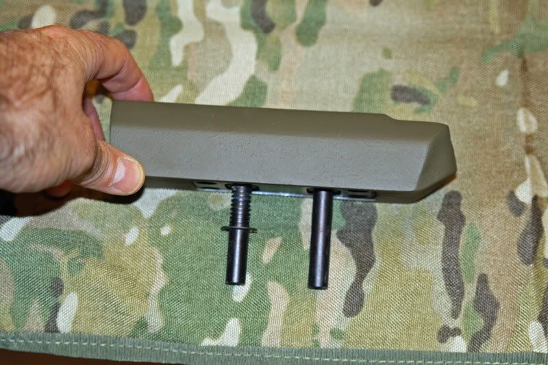

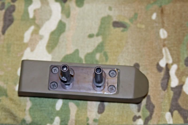

I have the MCS-T2A with the KMW Cheek Hardware,the best there is for ease of removal and replacement to the exact same spot). With the stock you do NOT need to remove or lower the cheek piece to remove the bolt - at least on the Surgeon SA.
This is a surgeon SA in .260 with Badger DBM Bottom metal running AI magazines.
Notice the little flange on the rear post. The cheek rests on that flange - which can be removed and placed on any of the available slots - and is held in place by the lower hardware in the rifle.
Notice the allen holes in the bottom of the cheek posts and teh slots going to either side of the cheek hardware; these allow the posts to be adjusted to offset the cheek piece so that the shooter is directly behind the optics. Freakin GREAT idea.
