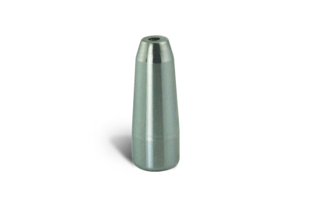

Below is a closeup macro photo of a RCBS .243 expander that badly needs to be polished. And I can understand why some reloaders do not want to drag a rough expander through their case necks. But even a expander like the one below can be polished smooth and lubing inside the case neck works wonders and lowers drag.
Below is a Whidden expander and they are not shaped like expander mandrels.

The Whidden is MUCH more like an mandrel than a typical button. It has a smooth even diameter section at the top. More importantly, it's works exceptionally well and how something actually works trumps our theory and speculation every time.

I have found that in neck turned cases using a quality expander--like what Whidden offers, makes seating smoother and seating pressure more consistent. That is what I have seen while using a 21st Century Hydro Seater that measures the PSI required to seat cases.
Whidden and some other companies offer excellent expanders for the dies that come in .001" size increments. So what you do is pick a bushing that sizes
the neck down the minimum amount required for the selected expander.
