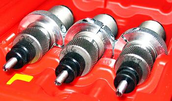

Below are just some of my .223 dies I used and tested over the years, and I prefer using the Forster die with its expander.
