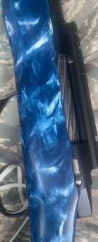

A couple more of that unique shroud and action profile. I just picked it up today. Can’t wait for the state midrange.
