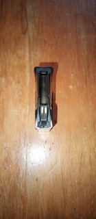

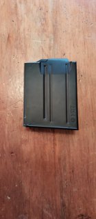

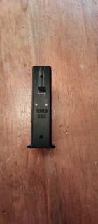

Nowadays there are a number of Accuracy International type of mags. Is it possible you have an AW or AX type of magazine? Please post a picture of the magazine you have.

Oh, okay. So your barreled action is a 223 Rem? If that's the case I've had good experiences with the Accurate Mag in 223. AICS clone. You could try comparing dimensions between your Magpul AICS and your MDT AICS.

It looks like the magazine he wants to use is for a 223 Rem. The way magazine manufacturers handle that for an AICS clone mag is they insert a polymer liner onto a regular AICS mag to take up the space not needed for a 223. What that means is the feed lips are a layer of polymer between the steel magazine feed lips and the cartridge.
