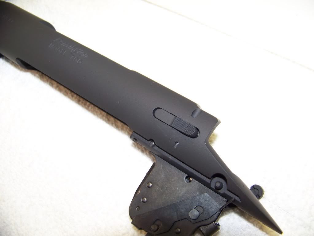

Stiller will sell you the parts from a Viper or Predator. The Sinclair piece is simple and effective but unacceptably ugly IMO.
Both the Stiller and the Defiance Machine are good looking solutions...contacted both. I'll take pictures when it's done and post.

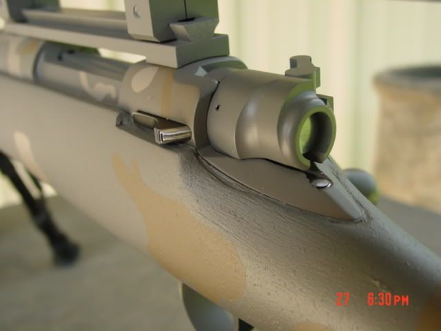

This is on my Grandson's mod 600 Remington. It is an Anshutz. Be sure to place it as far back on the rear receiver ring as possible. If not your bolt might not retract far enough to feed the next round in the magazine.
Butch
Look at the way Lawton installs thiers. Instead of a roll pin and a hole drilled through top to bottom. They use a blind hole and thread the bottom part. Then the pin is a screw with the threads turned down where it runs though the release. Easy to remove and looks cleaner.
Just noticed that the one pictured above must have ben done in a similar fashion.
