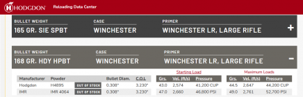

Hodgdon's M1 Garand Service load data...

CMP (DCMP) has issued pressure warnings! These guns are over 70 years old and Hornady has a section devoted to the M1. Victims of over-pressured loads are the OP-ROD, BOLT, and the RECEIVER. If you go to Camp Perry, they'll also have load advisories not to exceed 49,000 cup pressure. 4895 and 4064 work well
