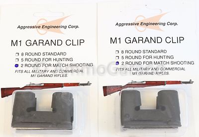

You might look into the 2-round clips commonly used for Rapid Fire strings.
Place one blank in the chamber, then press down the 2-round Enbloc down low enough, controlling the bolt via Oprod, allowing the bolt to move forward without picking up a round.
Just after the bolt has cleared the top round in the Enbloc, allow bolt to go forward under it’s remaining travel to seat chambered blank.
We have used this process on many of the VFW, AM. Legion, and Disabled Veteran’s Post’s Ceremonies/practices.
The “Ping” is identical to standard, and 5-round Enblocs.
