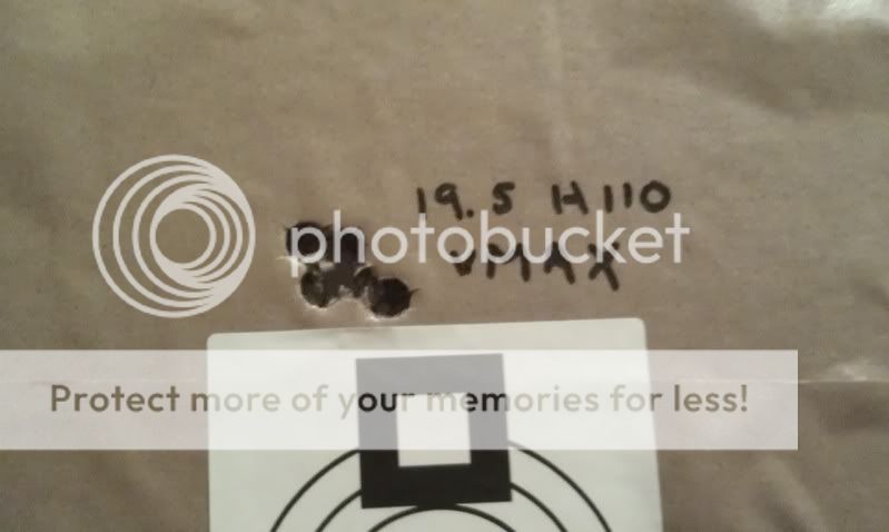

Ok, maybe it is not a stabilization issue but I have not got Amax's, Accubonds, SMK's, SST or pretty much anything in the 150 up to group at supersonic speeds. 110-125 have worked great. Used 125 Lapuas, 110 VMax, several 110 varmints, and 125 SMK.
Mine likes 125 SMK and 110 Vmax.
100 yards
