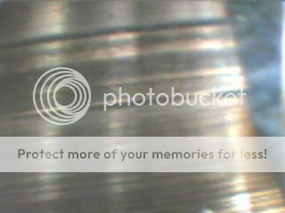

Well, this thing is either the best thing I've bought, or the worst, LOL
I've been using it mainly to better my cleaning procedure. I do have a question on a picture I took in this bore.
Rifle barrel is a Krieger, chambered in 300wsm, Rifle has about 80 rounds through it. On this one, I was just going with the shoot and clean, I did not do the whole shoot one round and clean, etc. So the rifle has been cleaned only about 3 times. Those times I was just using wipe-out.
What you are seeing is a cleaning with KG products, I used the carbon cleaner, then the copper cleaner. Testing different products at the moment.
Then, I read the Krieger article about barrel break-in. Think I may have screwed up here, and should have followed their schedule. It basically saws the whole 1 and clean deal, and makes a good case about the possibility of getting excessive copper from the jacket while the throat is being fired in
So what do folks think? The copper seems a bit extreme to me? Thinking about coming back with some Iosso paste, and getting it out, basically trying to start over, and remove the copper build-up, then go from there.
Rifle shoots great. This is my first bore scope by the way.
Thoughts?

Thanks for the input. Approaching the question slightly differently. From the picture, would this be considered heavy copper? From those who have looked at a bunch on barrels.
Those with scopes, are you looking to get pretty much all the copper out in your cleanings?
Do you leave a bit, and on the black, I don't suppose I would ever get everything out, how far do you take it though?
Just trying to fine tune my cleaning, whats good enough

The pic does not show excessive copper. It looks very normal. Do not kill yourself trying to clean it perfectly as that is a waste of time. I enjoy my borescope and what it lets me see but you have to understand that you may do more harm than good trying to get every speck of copper out of the bore. Carbon concerns me much more. One thing I like about being able to scope my bore is being able to keep track of carbon in the chamber and just beyond. I would worry about that more than the little bit of copper you are seeing. One thing I've noticed is the carbon in the middle of my barrel and the copper right at the muzzle (both normal). Enjoy your borescope but don't over analyze what is going on.
As said above, that is not excessive but it is there. I also have and use Lyman Borescope.
One wipe with some Barnes CR-10 and that's gone. Kroil after and you are good to go.
That's not copper fouled. I once picked up a Marlin 30-30 that had so much copper in it the corners of the grooves/lands were filled in with copper - sort of polygonal shaped. So much copper that it was curling out from the muzzle and over hanging the crown. Since it was California I assumed the owner was shooting copper bullets to accommodate the lead-free hunting rule there and just did not know how to remove the fouling. It was scary to look at and can't imagine any other way to remove it all except electronically.

You are seeing two things
Copper fouling
Cutter marks from a cut rifle barrel
Use Montana Extreme copper killer on a wool mop, let it soak, copper will be gone. This products works faster than Sweets, CR-10, Hoppes copper remover, and Butches is slow as grand ma.
Due to the cutter marks, coppering will continue for the life of the barrel.
