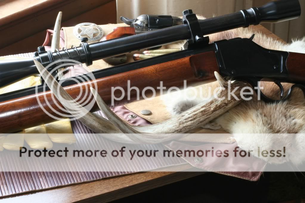

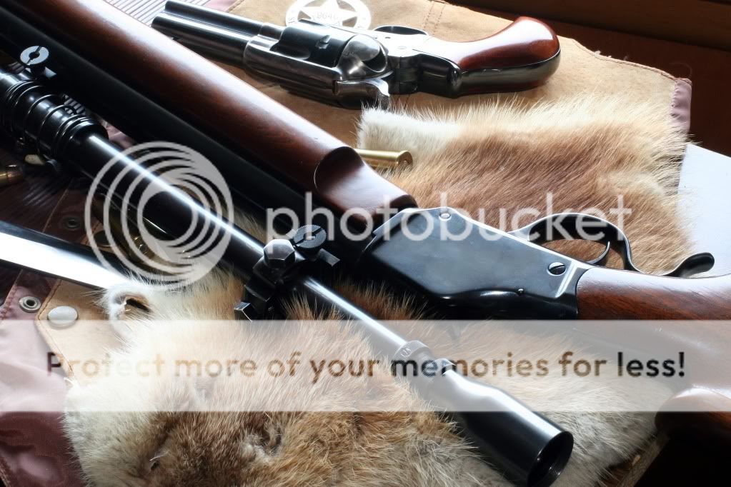

IMG_3236.JPG IMG_3235.JPG IMG_3236.JPG IMG_3235.JPG About 4 Months ago a friend stated he was going to take a gun to the sheriff office to have it destroyed as he couldn't get any ammunition for it. I tried to convince him that he was making a mistake and that he should give me the gun instead. Then a couple weeks ago I asked what he had decided and informed him it would go to a good home and be passed down to my children and grand children (hope I have some). He said he would bring it to me, he didn't know what the gun was all he knew was it was really heavy and he couldn't get bullets. Well See for yourself why I am feeling like its the luckiest day ever. Pictures aren't perfect but should get my point across. Just happy I saved it from being destroyed.

Its chambered in 219 Zipper Improved, So if anyone knows about these I am all ears.
I have very similar, but mine has close set double set triggers, yours appears to have a single set trigger. Mine is also a 219 zipper improved. You can't get ammo because it's a wildcat made on 25-35 cartridge or off a 30-30. There would be a number of steps involved in making ammo for for this rifle. If you don't know what your doing, you'll have to depend on the skills of a good smith. 33-30 necked down to 22 caliber.
Mine launches 55 gr max about 3650 fps Good luck with that beautiful old timer

Kinda bummed now searched it high and low and it has no serial number. I will still enjoy it but I need to get it from Virgina to Arizona and not sure I can fly with it or ship it with no serial number. From what I can find on the inter web the SN# was on the lower tang but it appears it's been modified with this pistol grip style stock and there is no number. I have had the stock off and no numbers there and I took the forearm off and nothing there except a P stamped into the action. :(
Reed's ammo claims they have .219 Zipper loaded ammo. Might be able to fire-form in your chamber as that was a common practice back in the day. Once formed in your chamber you can do as suggested above and get custom dies made by Widdens or some other CUSTOM die-maker. OR you could sell it to me and I will make it shoot! dedogs
You can fly with it. There is no serial number, not even an inspection. Just declare it and follow the laws and rules. --jerry
