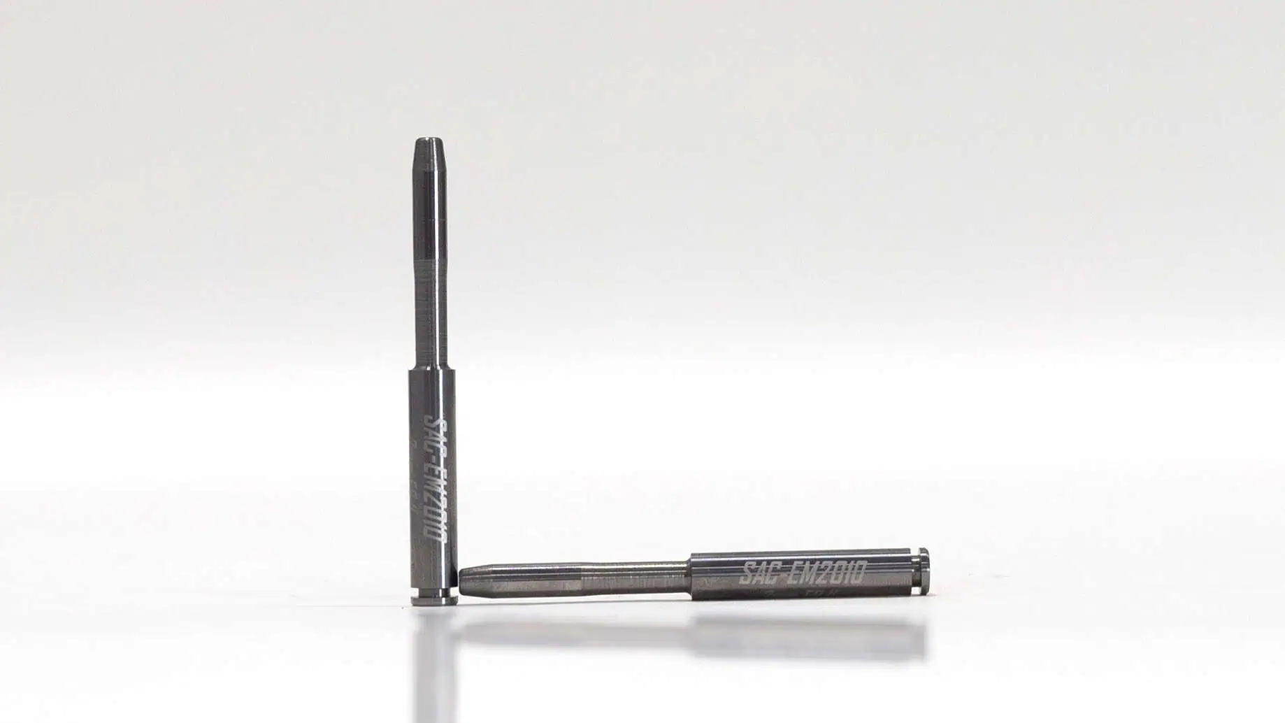

When I use carbide pins, no lube is ever needed. Short Action Customs makes them in .0005 increments. No galling and they work perfectly.
Everything from SAC is great, but their website says their mandrels only work with their own dies, but that is incorrect. I use mine in a Porter precision dies, since I already owned a few.

Technically, a SAC expander mandrel will work in the Porter but, not in the way SAC intends their mandrel to operate. Any expander mandrel (pin gage, SAC etc.) used in a Porter works on the downstroke; it expands the neck from the mouth to the shoulder. When a SAC expander mandrel is used in a SAC modular die, the expander operates on the upstroke from the shoulder towards the mouth. I don't want to put words in SAC's mouth but their reason for the design is to eliminate expanding an unsupported neck, whether that makes much difference or not is a matter of opinion I suppose .
