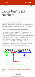

All the quality 22LR ammo I buy is by the brick (10 boxes) and all that ten will be same lot number.
Now and again I see those "in the know" rimfire guys express (when asked) the lot number as a "Speed" number (example 25 speed) instead of the printed lot number. The lot testing targets I have seen from some Anschutz rifles have all been labeled with numbers such as 033, 036, 029, etc.
Is there a place inside that long lot number that I should key on as a "speed number"?
Lapua Rimfire Lot Numbers​
Home » Knowledge Base » Lapua Rimfire Lot Numbers
Current Lapua rimfire ammo lot numbers are composed of eleven (11) digits, five (5) digits followed by a forward slash, followed by another six (6) digits.
The five digits before before the forward slash:
  • First two digits (digits 1 and 2): Prepend a ‘3’ in front of the digits to get muzzle Velocity in meters per second. Example: If first two digits are 27, then the muzzle velocity is 327 meters per second.
  • The last two digits (digits 4 and 5): Year of production code. 54 = 2019, 55 = 2020, etc.
The six digits after the forward slash is the actual lot number (assumed to increment sequentially).
Thank you my friend!
The meters per second makes the whole mystery clear.
All I would need to do is use one of the online conversion sites to get the FPS numbers.
