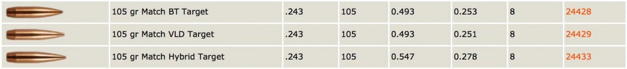

Thanks! Hadn't seen that news bit before. Wonder which Berger 105 they chose? My preference being the VLD....
