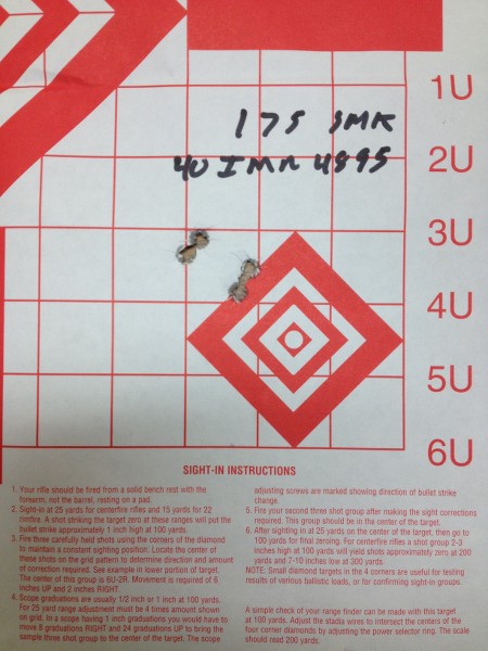

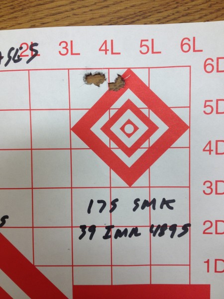

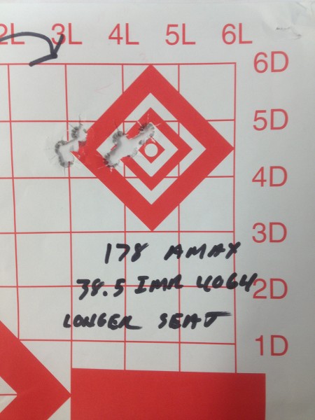

Check these groups out . Do you think I'd ever really known there was a problem if I only shot 3rd groups . These were all shot during load development . and although I had seen these double groups come up from time to time I figured it was me . Then one day I shot that bottom pic which is a 10 round double group . No way that was a normal thing .
Anyone want to guess what the problem turned out to be ?????
Loose action screws.

If this was directed to me I'd agree that when ever a issue comes up it's uncontrollable until it's identified then controlled for further testing to determine for sure that was the actual problem . Until a problem is identified it will be uncontrollable which mine was for 6 months until I figured out it was the action screws . Once tightened and Loctite applied I've not shot a double group since , That's about 1500rds or so
