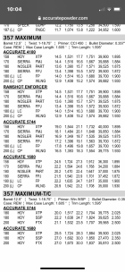

I experimented with 1680 when I was loading 350 and I used 357 maximum data.

1680 works but is a little too slow for a gas gun with a 16" barrel. if you have a bolt gun and one of the longer barrels you should get some decent speeds
In bolt actions I use 200 to 250g .358 diameter cast bullets with 12g of 2400.
It's a 1.5" load at 100 yards for 5 shots regularly and breaks MOA often enough to be interesting. Both guns i use are Ruger Americans.
