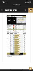

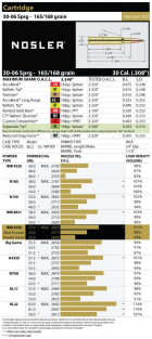

Every rifle and barrel will show variations from loading manuals and shooter's data. You will need to test with your components and your rifle to achieve the best information. Here are a couple of examples for two of the Nosler bullets:
Enjoy the process!
