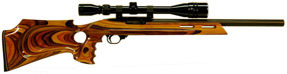

I am pretty limited as to stock selection. The NRA Rifle Silhouette rules are rather restrictive and I shoot left handed with a right handed action.
I am looking at something like this for a stock:
Or possibly this:
This one looks to me to have a pistol grip but the manufacturer claims that it is NRA Silhouette compliant.
In the past I used stocks like this:
But I could never really get my left hand (trigger hand) comfortable so I am looking at different configurations.
That anschutz pattern mcmillan you showed first (the blue one) is the standard by which all other silhouette stocks are judged. You can hold it solid as a rock. All parts of that stock were made for MS hence the anschutz model number 54MS. If you were closer to me id let you try mine on my swingers

Actually that is the Mcmillan Anschutz Silhouette as the Master Silhouette is not available for a left handed shooter.
Here is the Mcmillan MS. Not a whole lot different. A little beefier in the grip and cheek piece area and the cheek piece is a little higher.
And the Mcmillan Anschutz for comparison:
The Mcmillan Anschutz is available in a left handed shooter/right handed action configuration.
The Richard's Microfit"Tac-Driver" Silhouette Style looks interesting and would be much quicker to get than the Mcmillan. Probably worth a try.
If its a typical richards stock you just take a piece of wood, knock the bark off of it then shape it to whatever you want. A sporter or varmint stock are the same its just how much wood you whiddle off
