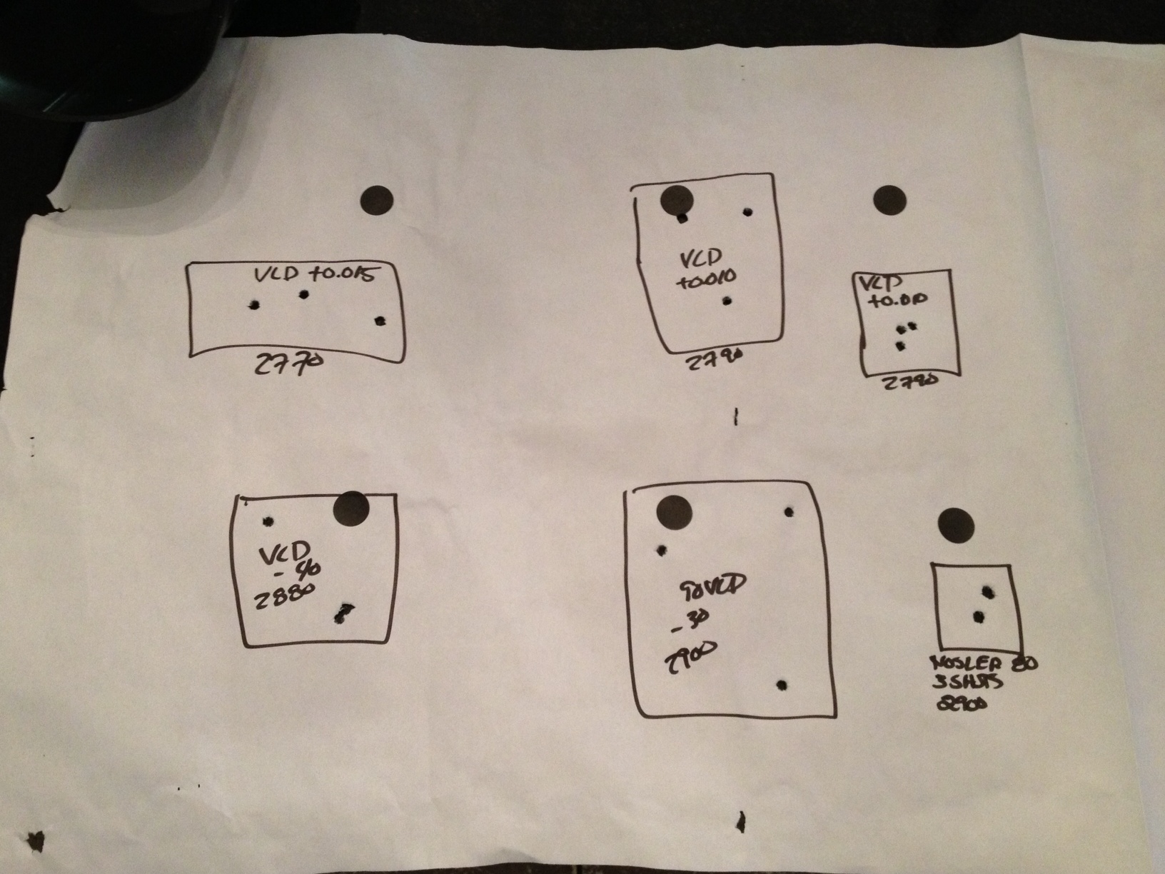

Another quick test.
As I usually do I shot 3 shots with something that I had loaded so I wasn't doing a cold bore shot in the test. The bottom right group is 3 shots with Nostler 80s at 2900FPS, this load is not set up for this gun, it's set up for my White Oak Service rifle and only a little over mag length. I'm going to have to go and see how far it's jumping but I'm betting at least -0.060. In any case the 1st and 2nd bullets effectively went in the same hole, the whole group is under .25MOA
The rest of the groups are with Berger 90s, MVs are listed. The lower two were some stuff I had loaded from a ladder jamming 10 that didn't get shot because I hit pressure so I pushed them back to -0.030 and -0.040 just to see what they'd do.
The upper groups were shot right to left. The first group jammed +0.010 looked good at about .25MOA, and the 4th shot would have been in there, but the next two went high and wide.
The upper left group is +0.015, same load as the +0.010 loads. Vertical is great, but the over an MOA spread is bothersome.
I just sold off a load of Berger 308s that I could never get to shoot, I am not a tinkerer, I really hate doing this much load work to try to get these things to work.
If I could figure out something at the -0.040 range that would be great, the MVs not jammed are way better than jammed.
Believe it or not I think I have found a sweet spot jumping 0.030.
Jumping gets me about 100 FPS more MV w/o pressure signs. I'm going to try to work with this.
