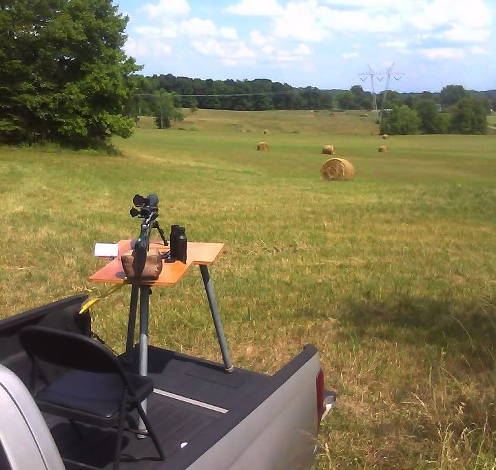

The white card to the left of my rifle is my range card. I set the card up backwards using turret settings instead of yardage. So for every .5 MOA of scope adjustment it tells me the POI yardage. I do it this way because the settings change fairly rapidly when you get beyond 600 yards.
