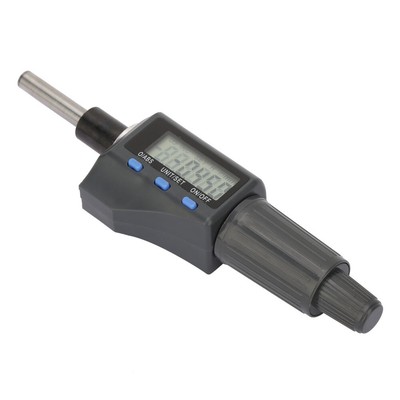

I'm looking to make up something similar to this but I would like to use a 0-2" digital micrometer head for a few reasons. I'm looking for digital because it's easy to zero at different datums and I can switch between metric and imperial.
Has anyone come across an economical 0-2" version of the below?
I made a similar tool but used a digital indicator rather than using a micrometer head. Works great for bbl chambering. I've used the same concept to make digital bump gauges. For this, it helps to modify a large tip by making sure the primer doesn't give false readings on fired brass.
