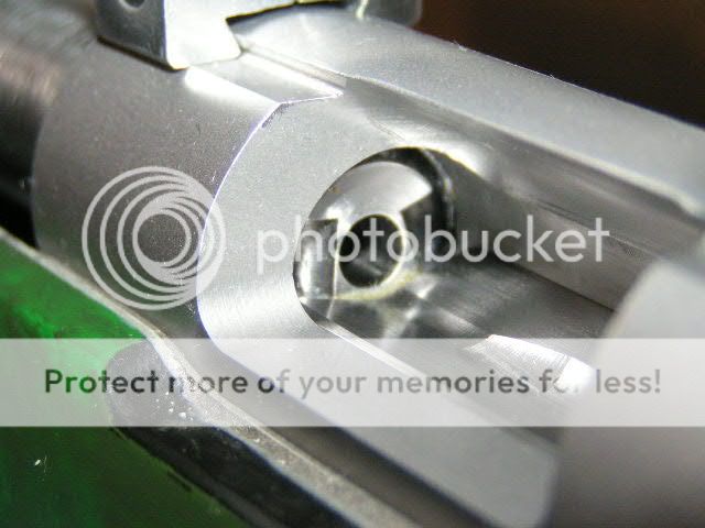

For rimfires I eventually realized that a standard end mill would work just fine. The large relief has the added advantage of giving excess lube a place to go so the boltface stays clean.

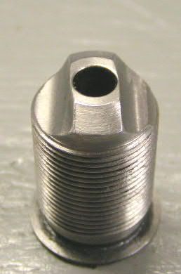

I just set the barrel in v-block and surface plate hanging on side of the mill table and cut between the lines on the conned breech. I made a tool from a hss bit ground to snugly fit the race way to mark the cut out area.
