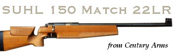

Suhl 150-1
The Holy Grail bargain .22LR bolt gun is a Suhl 150 -- but they are hard to find now. It still makes me wince when I realize these could be had in new-new condition for under $400.00 not that long ago. The barrels and triggers are so good that many Suhls were converted into benchrest guns. See: http://www.6mmbr.com/gunweek089.html
