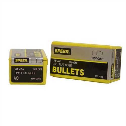

I have looked at every reloading sight I can find online, no one has them. Looking for 150, 170, or heavier, .321 jacketed diameter bullets. Have lead bullets and molds, looking for some in jacketed to see how they shoot in the rifle to establish a accuracy guideline. Would like to buy 200 or more.
The Hornady 32 Special bullet has to be short loaded to use in the 32-40. I never tried the Speer bullet in the 32-40, but i assume that because these are .32 W. S. bullets that they would also need to be short loaded.
Short loaded for the bullet design, not the cartridge.
You can contact Hawk bullets and see if they offer a bullet with the cannelure in the right place.
