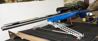

This is my Gnergy bipod

Look at the ones that forum member Gnergy makes, I have used them in the past and they are awesome, he is a one on one type of guy and will chat with you to make sure that you have everything that you need.

This. I usea GNERGY made bipod and it is awesome
