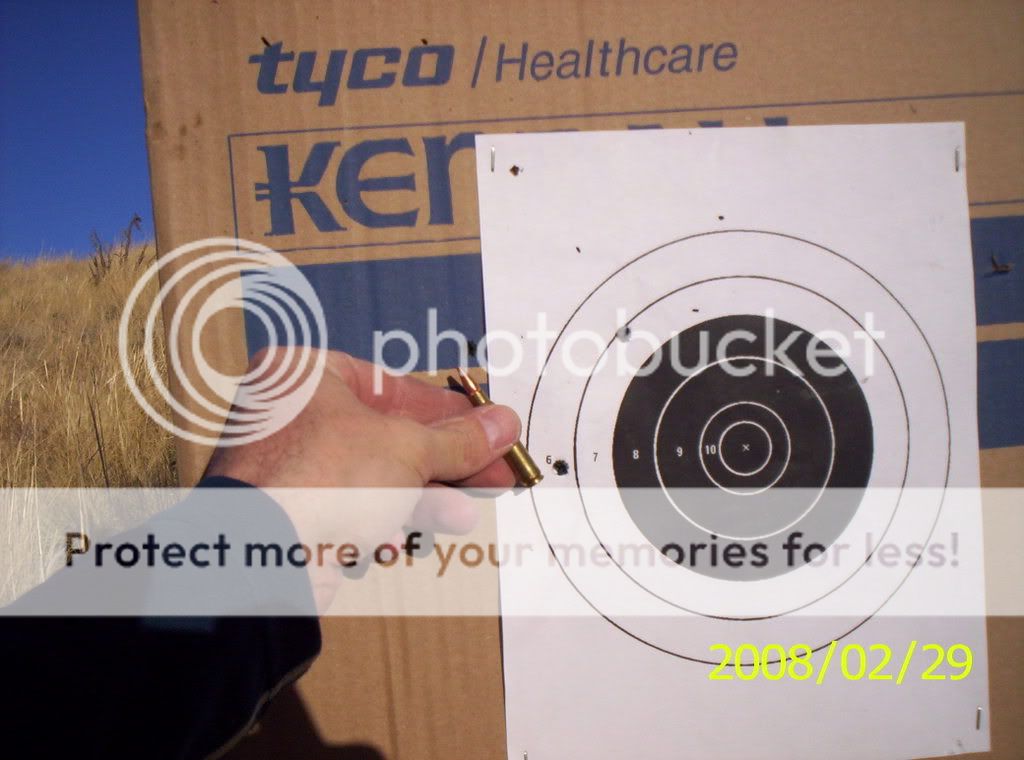

Here's a 875 yard target with the above load.
