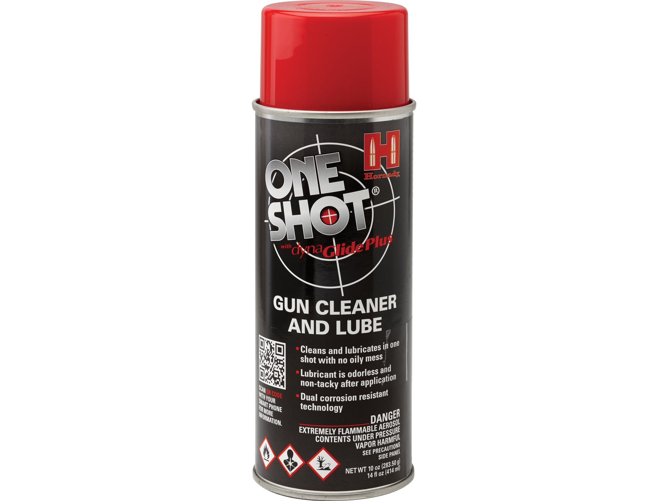

Here in the South, I worry about chrome moly barrels, Hornady One shot and Frog lube are the best I have ever tested. I put a single barrel shotgun in my hay barn for six months with zero rust exposed to the elements inside the barn with doors open....Hornady one shot is an incredible product:
