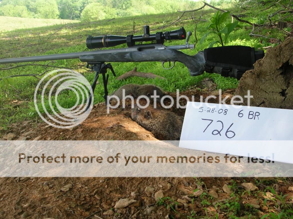

At longer range, 500 on out I've used 6BR, 65x47, 6.5-284, 264 Win, 300 Win, 300 WSM and 338 Norma.
The last few years I don't hesitate to grab the 6br or the 6.5x47, these two have killed more in the 500- 1000 range than all the others put together. I will shoot them with whatever I have with me but would rather use the 6 and 6.5
With today's excellent bullets, I believe any 6, 6.5 or 7mm non magnum cartridge will perform to your expectations out to at least 1000 yards. You'll need to do your part of course but todays bullets are meant to work in next zip codes. Just find which one your barrel loves and go to work.

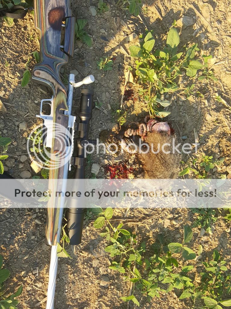

My recommendation is a 6 dasher, I used to shoot a CZ 204 Ruger, 220 Swift & 22-250 and frequently had shot opportunities out past 700 yards but the wind never cooperated and I'm not great reading the wind. My longest kill was 519 yards. I wanted a caliber that would buck the wind a little better so I had Dustin at SO Custom Rifles build me a 6 Dasher... wow what a hammer, unfortunately my longest attempt was 348 yards and I cut him in half with the Hornady 105. Hopefully I get more time out next year & can catch one out further.
