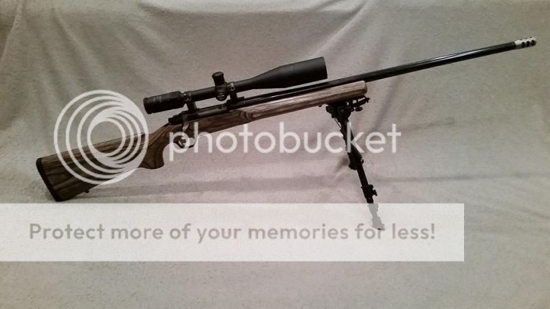

I just recently acquired my first decent rifle though it's not a high end 1000 yard shooter. But I do think I can have fun with it for 300-500 yard paper punching and varmint shooting. Anyways, never having shot a rifle of any quality and certainly nothing over 100 yards, I was wondering if I could get pointed in the direction of some good resources as far as reading or videos that I can use to learn better shooting habits and techniques. I'm also looking in to hand loading so I've been try to learn as much about that as I can but I guess that's a whole other discussion.
BTW...I'm in eastern WV if there's any chance that anyone reading this is not too far away. The rifle I got the other day in case anyone is wondering is a Ruger M77 MKII Varmit Target in .223. Like I said, not a 1000 yard precision rifle but when all you're used to are 50-75 yard shoots in the woods with an open sight 30-30 lever action or bustin' caps with an AR-15...it's quite a step up...lol

Is anyone familiar with this rifle and what the capabilities are (taking me out of the equation)? Anything that I can do to improve this gun specifically? I've heard the trigger leaves something to be desired and I assume that most or all rifles benefit from proper bedding which I'll look into for sure. I plan to reload so I'll be able to play with ammo configurations. Just wondering if there's anything else I can do that doesn't involve replacing major parts like the barrel or bolt. Or being new should I not even be worrying about this yet?
You need to spend your money on "good" precision loading dies. For use in a bench loading press, the Lee collet die does good for neck sizing, Redding makes good dies and I use their Comp Seating Die for my 223 used for 600 yd shooting. What is the twist rate of your barrel? Select bullets such as Berger's or Sierra match kings as they are more accurate than the 55 FMJ military type bullets. The 53 gr Hornady V-max is a good bullet for the money but limited to about 300/400 yds and they will shoot in the 1:12 twist barrels. The twist rate will be the deciding factor as to how long (weight) of a bullet you can stabilize in your barrel. Good luck and good shoooting
It's a 1:9 twist 26" barrel from the factory but it's had a muzzle break installed by the PO so I don't know how/if that affects anything. The muzzle break adds another 1 3/8" to the total length.
Nubster, I would have it pillar-bedded, have the trigger slicked up, get a lower set of rings on it so you have some chance of a cheek-weld (if you still cant get a cheek-weld out of it, break out the pipe insulation and duct tape), get some decent factory ammo in 55 to 69 gr bullet weight, and go have fun with it. Seymour
