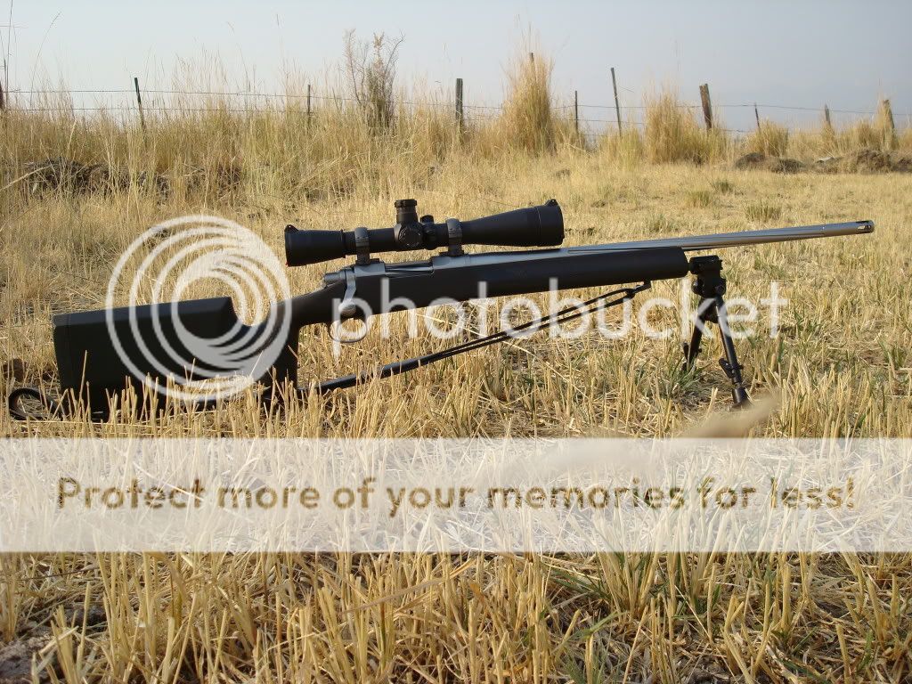

I have had pretty good luck with my Dasher with the 87 V-max at about 2950. On frontal hits or shoulder shots there is rarely an exit. Behind the shoulder is usually about a 1" exit. Easily repaired if you should desire to do so. Should be easy enough to duplicate in your .243. Good luck and hapy hunting. ;D Couldn't resist a pic of the new rifle. ;D
