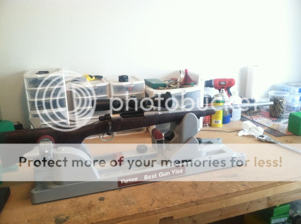

I got my rifle put together now time to start playing with loads. I picked up a Box of 200g Nosler e-tip and a bottle of IMR-4320 to start with. Plan to try some accubonds and partitions when I find some available to order up. Rifle came out like i wanted 8lbs with scope. Should make it nice for carrying around.
Shilen DGR action
Shilen hinged floor plate
Jewell trigger
B@C Alaskan II stock in red/black
Fluted PAC-Nor 22" barrel.
Scope on it now is just a Nikon omega i had sitting around. Leaning towards a Leupold CDS but haven't made a final decision.
