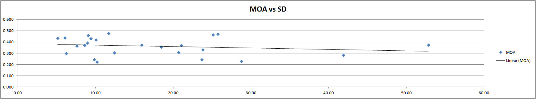

Velocity is nice and a low SD is nice too. However, small groups are what I'm after. Take a look at a recent batch of sub 1/2 MOA 5 shot groups at 100 yards made with my 6mm BR Norma. The graph shows MOA vs SD along with a trend line showing a slight bias toward higher SDs giving better accuracy; just the opposite from what one might expect. I'd be interested in seeing how your SDs compare with your MOA.
The chart is a little hard to see and I'm not sure how to display it larger. But if you click on it, you can see it larger and read the numbers better.
MOA vs SD
MOA vs SD
