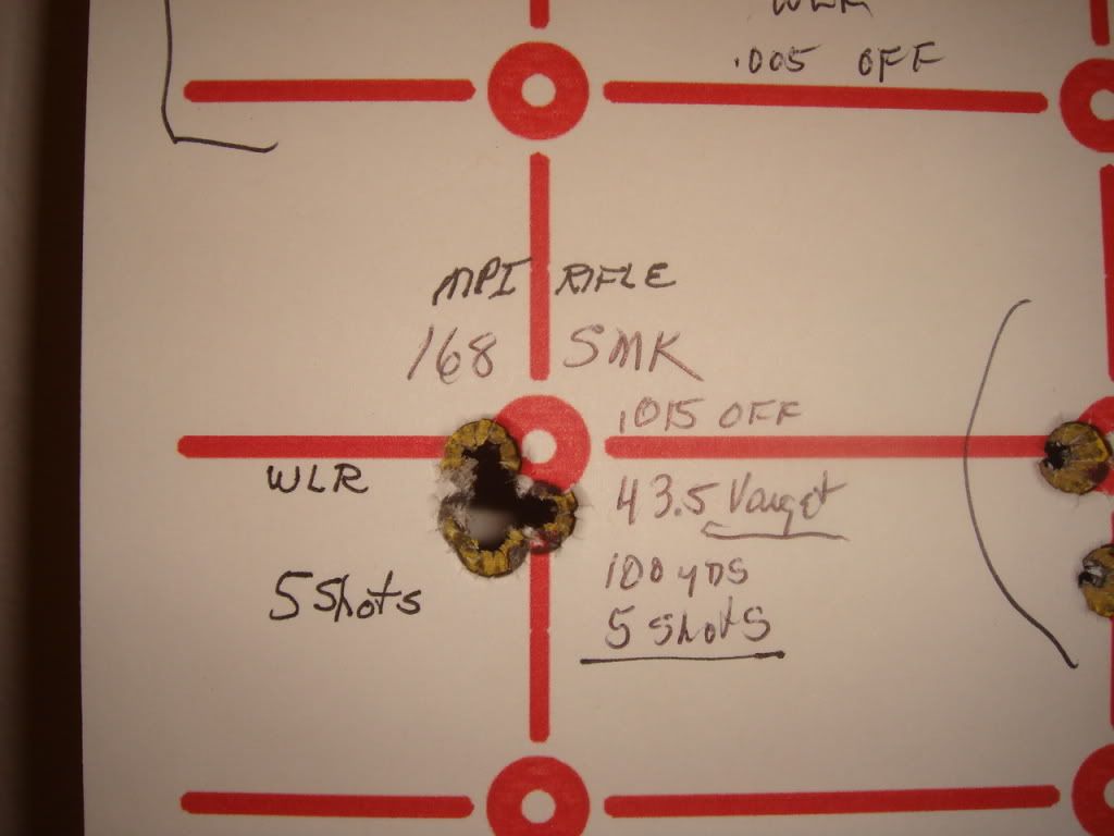

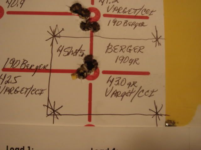

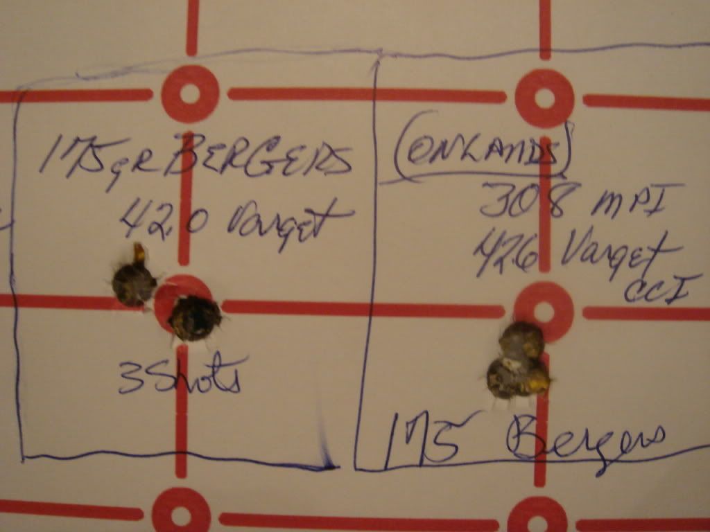

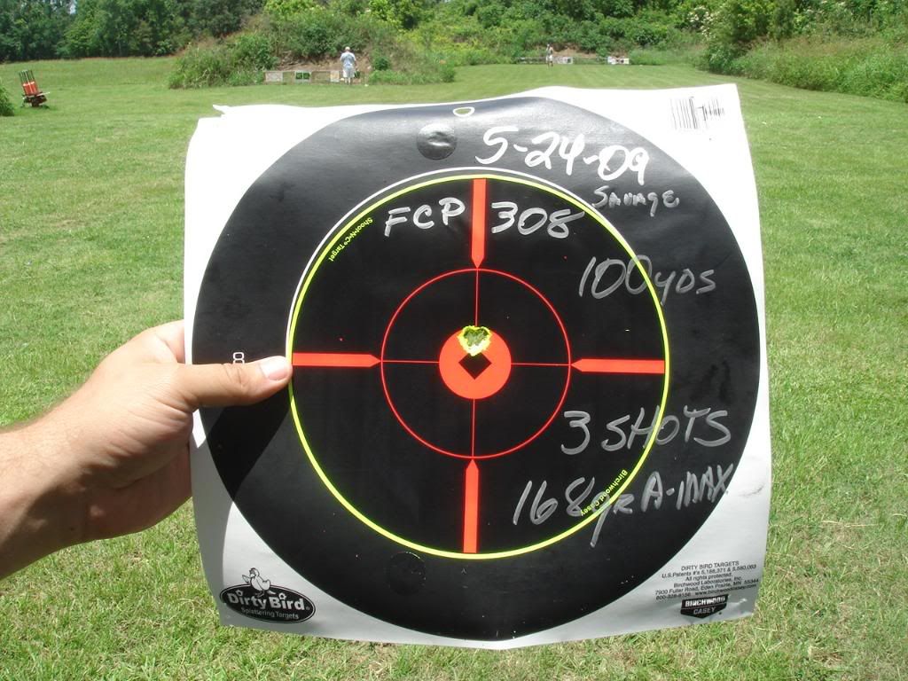

My 308 FCP love anything you put in it, factory or reloads, My favorite round to shoot is the 175 SMK's, I just don't have any pictures of the targets, but below is one with 168's, but again, It loves them all. I will include a picture with 190's, the gun for some reason loves 190 bergers on the lands with Varget and CCI primers, Lapua brass. The second pictures with the 168 amax's are factory loads!!!!!

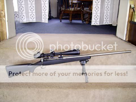

My rifle is a Savage 26 inch stainless heavy varmit barrel.
