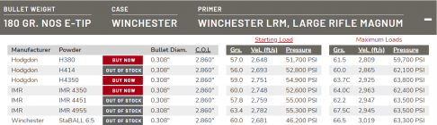

Use the Nosler Load data for your E tips, Nosler gives most accurate load data. This could be the short cut you are looking for and also could help you get some experience. Follow the instructions(data) exactly. Starting loads, work up. But remember if a starting load shoots well, a top load may only be 150-200 fps higher and wouldn't be a big terminal performance difference at normal hunting distance. Copper/monolithic bullets usually need 1800-2000 fps to start expanding, that will determine your max shooting range.
