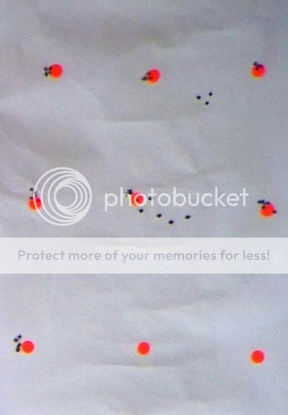

Where are the targets?
The target group at 200 yards.
(May not tightly group due to shooter error. Because I firstly attention on MV , SD , ES.
Will test again in detail for longer distance.
