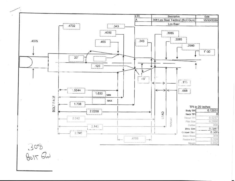

Rifle ; Les Baer Tactical Recon 24" Bull Barrel with 1:10 tw
Chamber is .343"nk , .098 fb , 1-30
