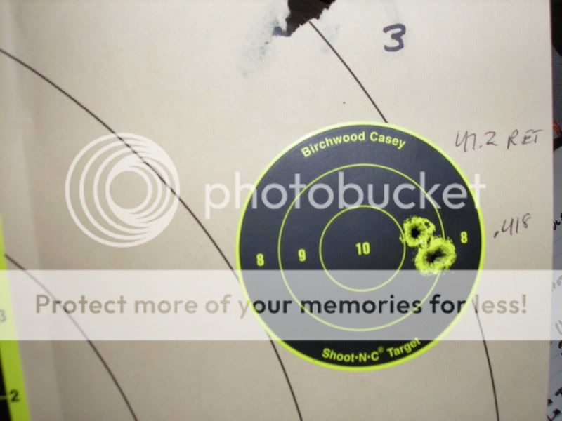

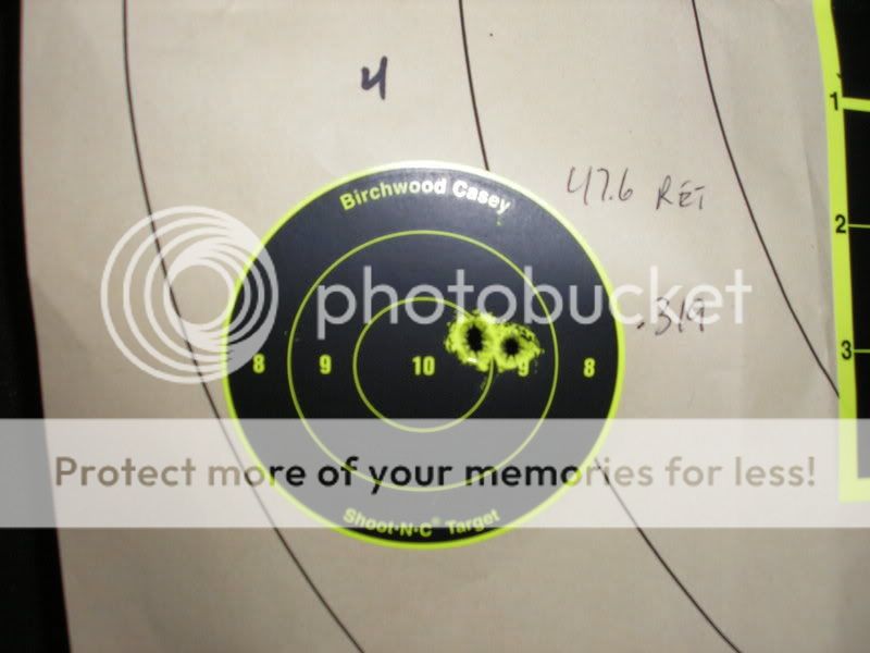

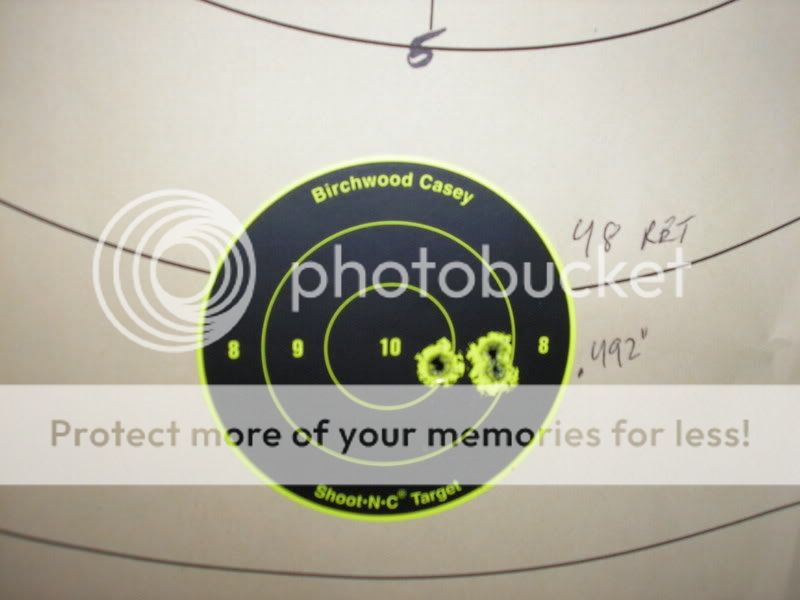

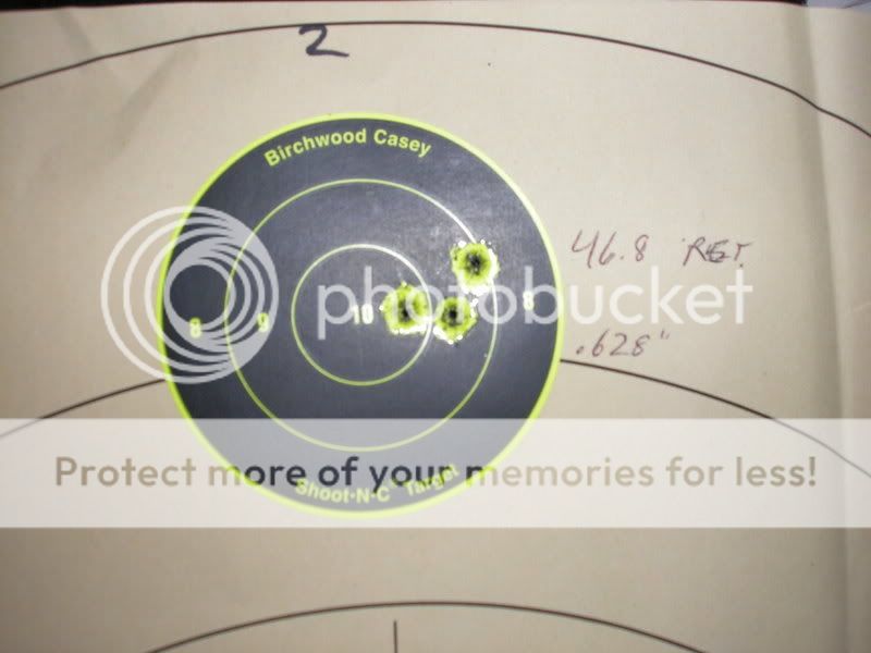

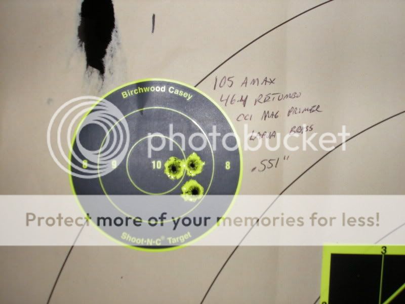

I built a .243 Winchester rifle intended for long range target shooting on a Stevens 200 short action with an 8 twist 28" Lothar Walther barrel. I've read about OCW but during load development I haven't really been able to tell a major difference in accuracy from load to load. Is this common? Could someone look at these targets and advise me on the correct load? I settled on the 48.4 Retumbo load, but am open to advice. Thanks in advance. These targets were shot at 100 yards.
I agree with 47.6...might try 47.4 and 47.8 to see if they stay in as nice a line as 47.6 for vertical dispersion.
I just went through this and with Erik Cortina's help I found a pretty good node. I'm now refining with seating depth adjustments. After looking at your targets, the last three are all shooting to basically the same point of impact with very little vertical. I would choose 48Gr's which is right in the middle of the node and play with seating depth. Perhaps you could ask Erik if he agrees with this observation. Check out his thread on long range load development at 100yds. It's further down the page in this section.
I agree with 48.0 since we don't know what I would do above 48.4 gr.
Load 48.0 and adjust seating depth and you will get there as it's obvious your rifle shoots.
