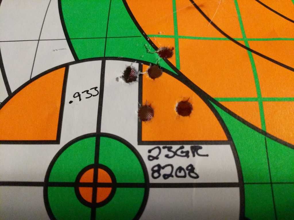

Heres the pics of groups for 55gr BKs.
23gr 8208

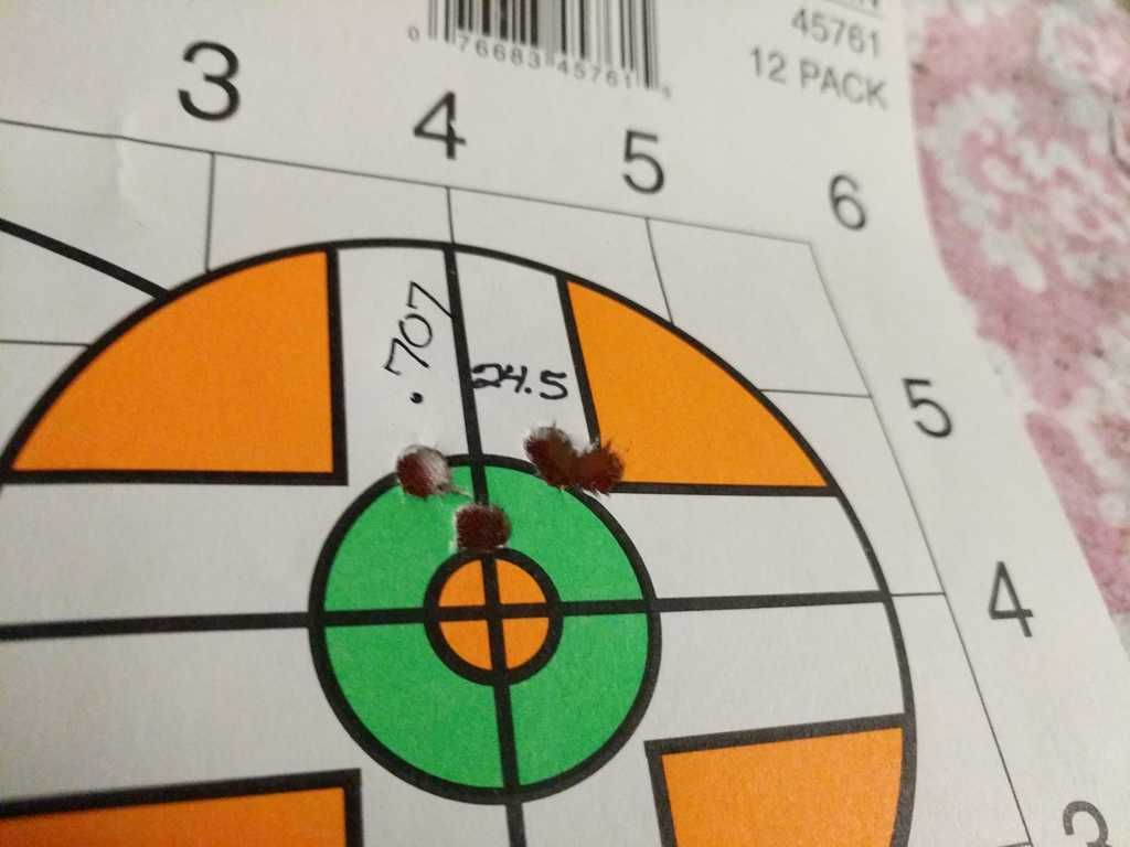

23.5

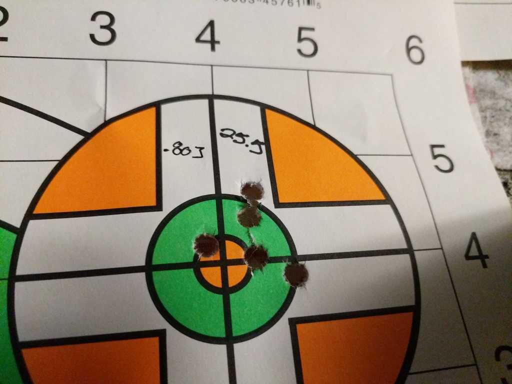

25
25.3

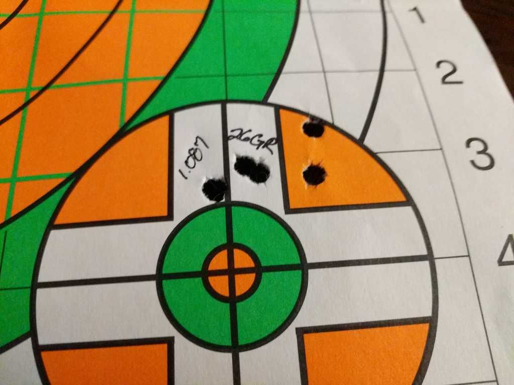

26

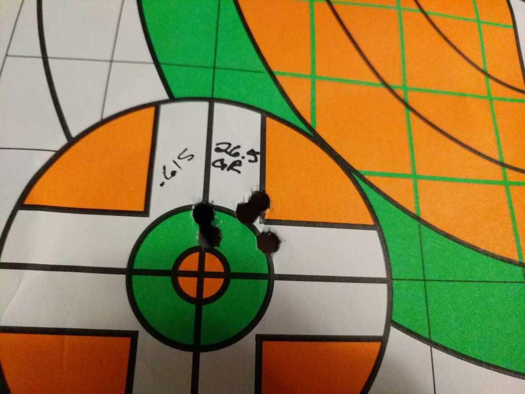

26.5

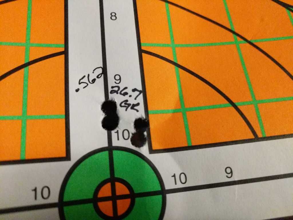

26.7

Morning all, need some input on load development for my 223. Using new Lapua brass, 55gr BlitzKings, CCI br primers and xbr 8208.
Last weekend I worked up my powder charge, and looks like the middle of the node is 24.5gr 8208.
So this weekend I loaded some rounds at 24.5gr of 8208, different lengths and these were the best ones.
1.885 cbto
1.875 cbto
Lands are at 1.891cbto, so I started at 1.890 and went down to 1.870 cbto which was almost saami oal. I was confident in all my shots, but I did not sort these bullets. Would sorting bullets make much of a difference you think? What would you do from here?

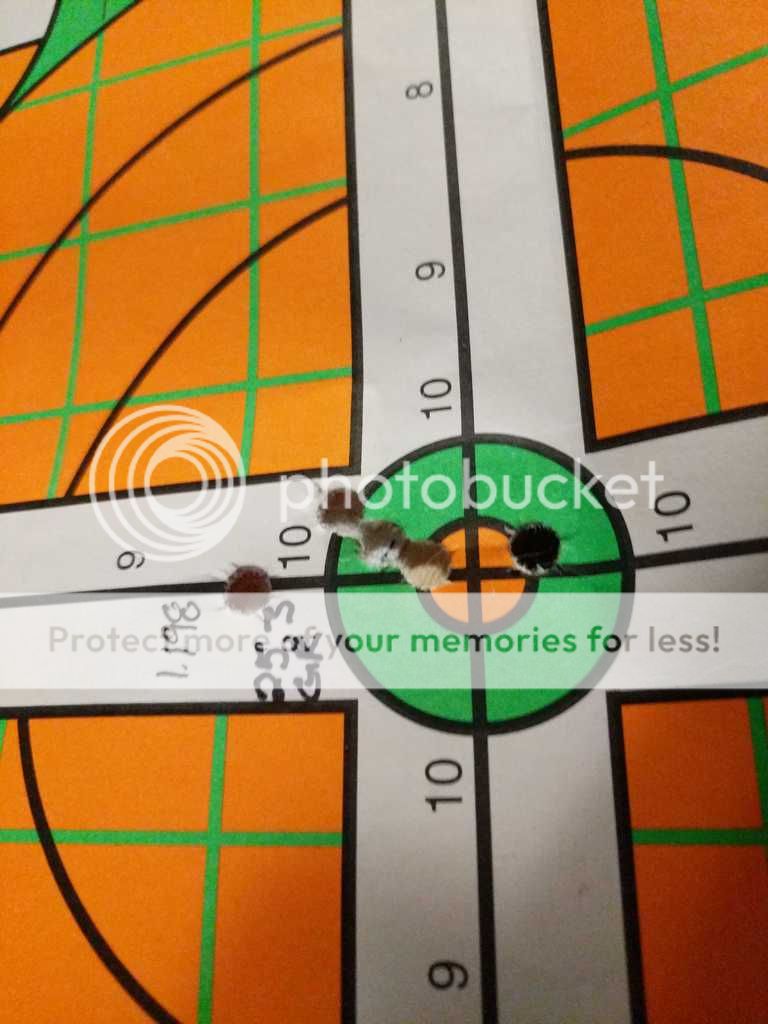

This was my around the upper weight of my initial load development with 69 gn SMK with CFE-223 , Fed 210M primers and Hornady brass for my Rem 700 223 5R milspec. Think it was near 0.17 MOA @ 100yds. Like I said ...initial load development, so only 3 rounds for each powder weight in my routine for development. I am fairly new to the reloading scene and I have tons to learn yet too. Started to amass my reloading gear about a year ago as well as scrounge the books and internet for related info on the subject in general. Have Hornady classic press, and mostly Hornady Dies currently. Nothing special from what I've garnered from the web. That was late last November, It's been 4 months since I've been able to get out ...getting nicer out again so I should be able to get out plinking and tinkering again soon.
