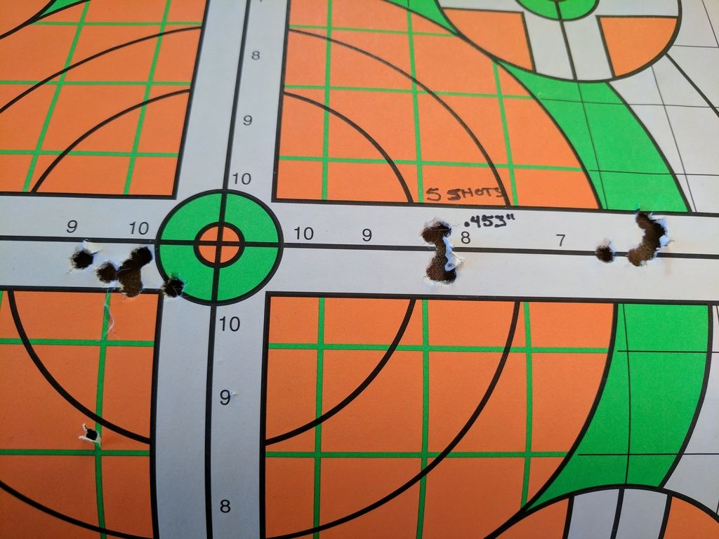

Morning all, need some input on load development for my 223. Using new Lapua brass, 55gr BlitzKings, CCI br primers and xbr 8208.
Last weekend I worked up my powder charge, and looks like the middle of the node is 24.5gr 8208.
So this weekend I loaded some rounds at 24.5gr of 8208, different lengths and these were the best ones.
1.885 cbto
1.875 cbto
Lands are at 1.891cbto, so I started at 1.890 and went down to 1.870 cbto which was almost saami oal. I was confident in all my shots, but I did not sort these bullets. Would sorting bullets make much of a difference you think? What would you do from here?
I'm looking for a good go to prairie dog load, something I can load 500 rounds at a time.
Using Redding premium deluxe dies.
Thanks in advance!

You don't mention your case prep ???
The vertical spread is more than I'd want to see.

My best results for 223 are with fireformed and neck sized cases and with good basic case prep including internal flash hole chamfering that produce groups like your .808 without fliers. ADI 2207 and Nosler 50gr BT. Rem Mod 7, suppressed.

The first thing I'd do is consider the bedding and free floating the barrel. This improved the accuracy of all the rifles where I had the action bedded or purchased a stock with a bedding block. Also free floating the barrel improved accuracy.
Went to stopp429's house tonight and we floated the barrel and bedded the action. I had no idea Remington used Boyd's thumbhole stocks... Ended up taking about 1/8" off the front end of the stock. I didn't think it was that bad...
So, with that huge pressure point eliminated, and action bedded nice and snug, do you think I'll have to do an ocw test again? I think I will, just to make sure.

As far as case prep, it was brand new Lapua match 223. Chamfered necks, Ran it all through my Redding FL die, then tumbled to get all case lube off, then loaded them.
If I still can't get it to shoot after this bedding compound curves I'll try a different primer.
